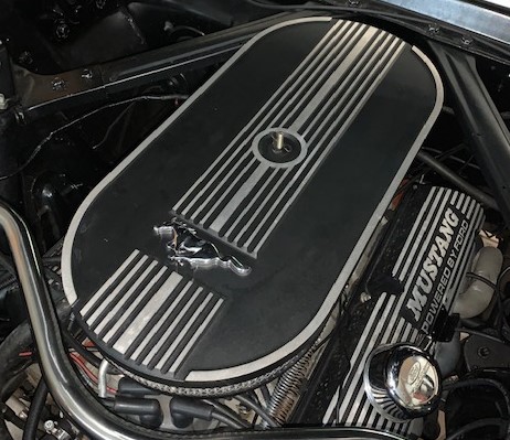

As they said in the video, TS6 or TS8 depends on the distributor. Short distributor take the TS6, tall one take the TS8. I just checked the Mallory Unilite distributor in my car and it is well below bar.
One other concern is your air filter. If it is a long one like this you need a completely different bar with a bend to the front.
