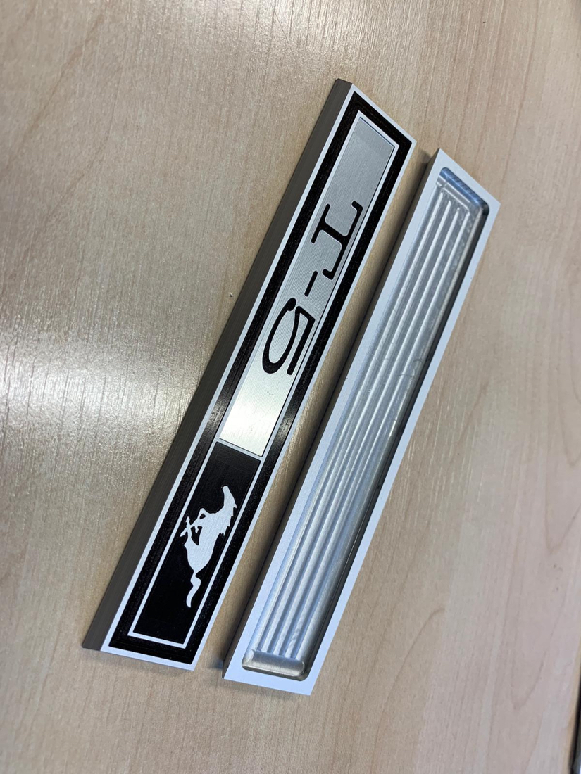

- 66CON
- Beiträge: 4559
67 S-Code GT390 Fastback
Re: 1967 Dash emblem 3d file?
Hi Stacy. Is me Felix and we were in contact via mail.
- 80AF911F-963D-4411-8A53-5DC2FEB75F09.jpeg (788.72 KiB) 2792 mal betrachtet
- Mitglied im
- Gruß Felix
- srhenson
- Beiträge: 16
- Registriert: Do 9. Jan 2020, 03:26
- Fuhrpark: 2008 GT500 Shelby
1967 Ford T5 (currently being restored)
Hello Felix, I wasn't sure at first that T5Owner was referring to you, but I soon figured that out. Your pic of the emblem really shows the workmanship that went into it. It looks great!
